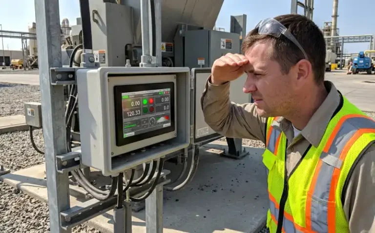

If the display you ordered claims 1000 nits, but the screen still becomes hard to read after you mount it on outdoor equipment, the problem may not be the brightness specification. The viewing angle, installation direction, cover glass treatment, and direct sunlight angle can all change what the operator actually sees. A brightness figure that looks acceptable in the datasheet may not perform the same way once the  Industrial tft lcd display is installed in a real cabinet under sunlight.
This happens more often than expected. A display works clearly on the bench during testing, but once it is mounted outdoors and the sun hits the screen at midday, readability drops. The specification has not changed, but the real-world result has.
Understanding outdoor display brightness requires looking beyond the brightness number. Several physical and optical factors work together to determine whether an operator can read the screen under actual outdoor conditions.

Direct Sunlight
Direct sunlight does more than increase ambient light. It creates a strong light source that can reflect off the screen surface or shine directly into the operator’s eyes. When the sun is low in the sky—early morning or late afternoon—it often strikes the screen at a shallow angle, creating strong reflections even if the display brightness is high.
At midday, the sun is higher, and the angle may reduce direct reflections, but the overall ambient light intensity increases. A display that looks readable at 8:00 AM may become difficult to see at noon, not because the display has changed, but because the lighting conditions have.
Testing a display indoors or on a cloudy day does not expose these conditions. The first time the equipment operates under full sun may be the first time the problem becomes visible.
